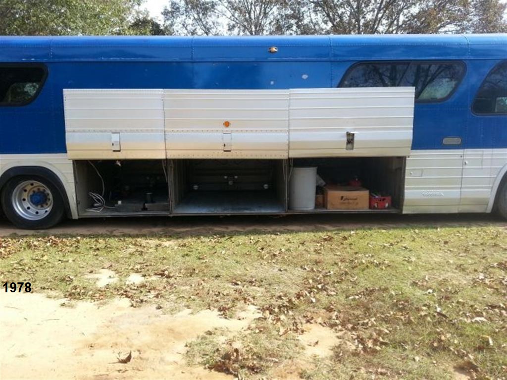

PostPosted: Tue Aug 09, 2016 1:03 pm    Post subject: Reply with quote
doors
 Filesize:  240.08 KB
 Viewed:  54013 Time(s)

Posts: 2762
PostPosted: Tue Aug 09, 2016 6:59 pm    Post subject: Reply with quote
I cannot supply you with any proof that the 'buffalo' was the first to employ the type, other than what I remember...when the PD-4107 came out in 1966, every other type of bus that I am aware of still had the old style baggage doors that were simply hinged at the top, and swung open from the bottom, and had to be secured open with a pin on a chain.
The MC-7 came out a few years later with a similar design to the 'buffalo's', but had an additional panel that pivoted up inside the door, covering the open gap that the 'buffalo's' had. This basic design continues today in just about all coaches.
The Eagle solved the problem by splitting their doors into a top and bottom half, and still was hinged at top, but folded itself to save space when opened.

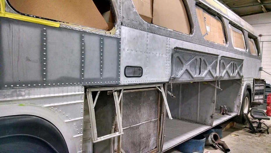

PostPosted: Tue Dec 27, 2016 6:20 pm    Post subject: Reply with quote
Buffalo luggage bay doors off
 Filesize:  222.41 KB
 Viewed:  53433 Time(s)

PostPosted: Tue Dec 27, 2016 6:31 pm    Post subject: Reply with quote
This is a Buffalo with the luggage bay doors removed.
From what I can see here, there appears to be a type of shield behind the door. To keep the rain off?
I don't know what year this bus was made
PostPosted: Wed Dec 28, 2016 6:17 pm    Post subject: Reply with quote
The Buffalo started in 1966 with the 4107 and continued to 1980 with the model H8H649 being the last.
The one in the photo would be a 4107 (two baggage doors). These were made from 1966 to 1979.

PostPosted: Sun Jan 01, 2017 11:56 pm    Post subject: Reply with quote
Traildriver mentioned a panel that kept the rain out from between the door and the luggage bay and from the looks of this it seems to be the panel that keeps the rain out and what the door hinges on. It would explain the way some doors protrude out at the top when something is wrong with them.

Posts: 2762
PostPosted: Mon Jan 02, 2017 12:09 am    Post subject: Reply with quote
I don't remember those panels...not to say they weren't there, I just don't remember them...the best I can recall was the doors swung out and up supported by the arms on each side, and when raised there was a gap between the bus and the raised door.
I definitely remember the MC-7 when changing from being hinged at the top the old way and transitioning to the new way, as having that panel...perhaps the early 4107's lacked them, and were changed later on? Not at all sure, sorry my memory is so fuzzy...
