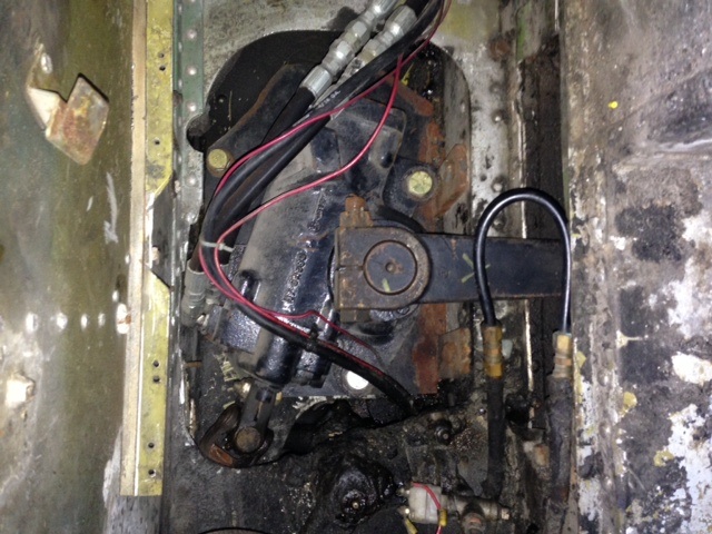

Hello there....
I have a 1947 GMC PD3751 Silverside Greyhound Bus that has had a power steering mod.
Can not turn front wheels while sitting still, but turns fine with both wheels off the ground.
The mod looks clean, got plenty fluid, but did notice a line rub near fluid tank... Does not seem to be rubbed all the way through, but will replace asap.
While on the ground, I can only move 22" steering wheel between 1/4 - 1/3 turn in either direction before stop and hear strain. (can feel in steering wheel)
From what I can tell by some of the numbers on the housing, the PS unit is for a Ford F7000 dump truck. I didn't do the work, so i cant say for sure.

I look forward to hearing from you & let me know if you want me to send some pictures of the pump/res/column.... on n on....

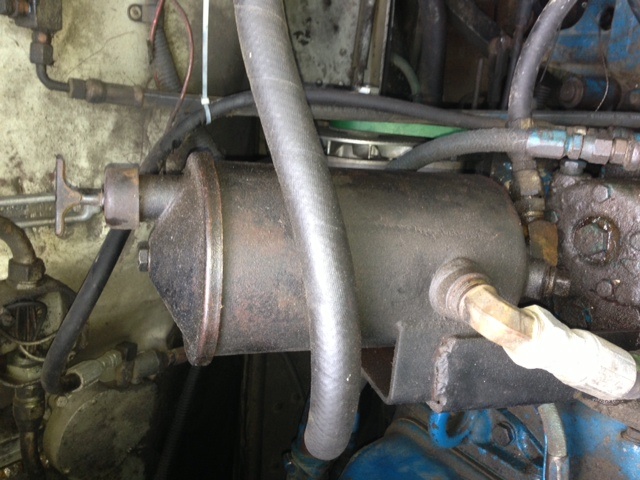

Pics of p/s pump and reservoir please.

Here's the res pic I happen to have on hand, ill take more pics tomorrow morning, or as soon as the thunderstorms leave town.... It's nasty and flood warnings happening right now.

PostPosted: Sun Jul 21, 2013 9:15 pm    Post subject: Reply with quote
If you remove the bolt on the cover, there is a spring under it. Then a washer, then a filter. Take the spring, washer and filter out. Bolt the cover back on, start the bus and try the steering.

I had the cover off the other day to check the fluid level because the foam piece at the dipstick cap kept wiping the fluid off the dipstick & i couldn't get a read. I didn't notice a spring or filter at that time.
I will get the long forceps & magnetic reacher to see if there is anything laying in the bottom.
If not, where do I find the part, or is it something I can make using proper materials?

PostPosted: Sun Jul 21, 2013 10:47 pm    Post subject: Reply with quote
Usually those reservoirs have that in them, somebody may have removed them already. It is possible the filter is still in there, as there a few different filters of different heights. I usually put on a disposable glove and reach in to grab the filter. If there is no filter, I am leaning toward the pump again.
And trust me, if the spring was in there you would not have missed it.
Sorry it took so long to get back, but the flood we had is just subsiding enough for me to get to the back of the bus.
I found the filter and washers together, but someone must have been in a hurry, cuz the spring was just laying on its side on the top of the filter.... Hmmm.
It made very little difference with the filter out & the fluid looks muddy. Also thicker than expected.... Scratching head.... Wonder if someone put something other than power steering fluid in there?

Should have told you this little piece of info- You should not expect to see power steering fluid in there. Could be motor oil, could be transmission fluid. If motor oil, it is probably 10w-30.
